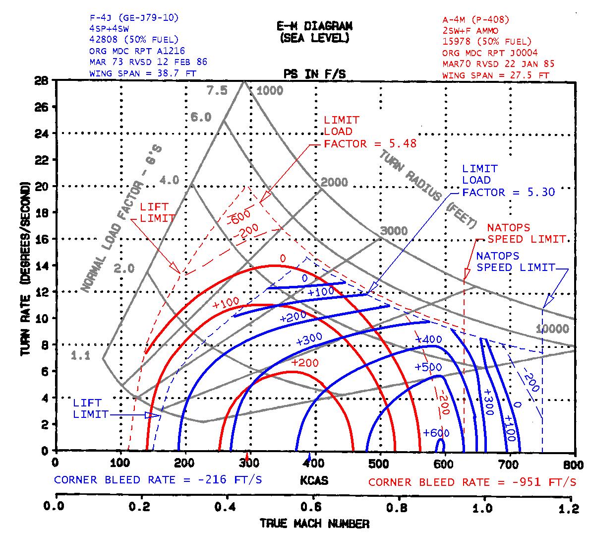

F4J verzus A-4M
MiG-21 bis, F-5, F-4 block 48
TOTO JE ÚVODNÍ KONCEPT F-15
