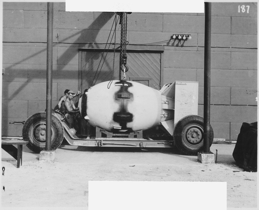

FM_(Fat_Man)_unit_being_placed_on_trailer_cradle_in_front_of_Assembly_Building_^2_-_NARA_-_519397.tif.jpg
Fat Man.
